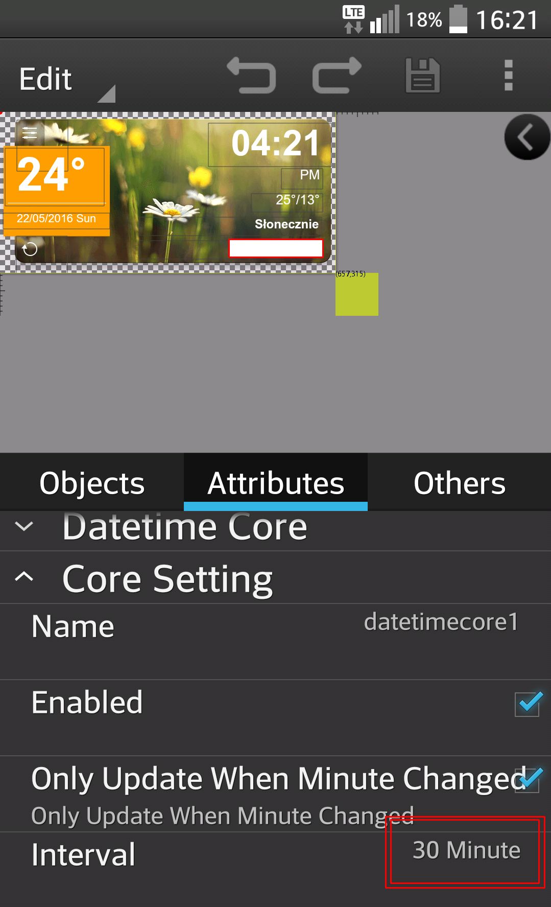

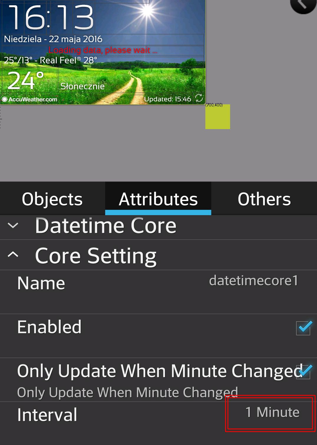

Test in progress.... in my LG G2 with Stock ROM 4.4.2
Error is in @datetimecore1
Look at screen. The default is 30 minutes in the Android !!!
Should be changed to one minute!
1. Option (tap on widget)
2. Edit Widget
3. Others
4. datetimecore1 --> Attributes
5. Core Setting --> Interval = 1 second !!!
6. Only update when minute changed = OFF !!!
Check it this !

@Jimking
Your widget

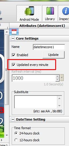

@ datetimecore1
I do not understand how it had come in Interval 30 minutes ??? I am writing here about the editor for Android.
