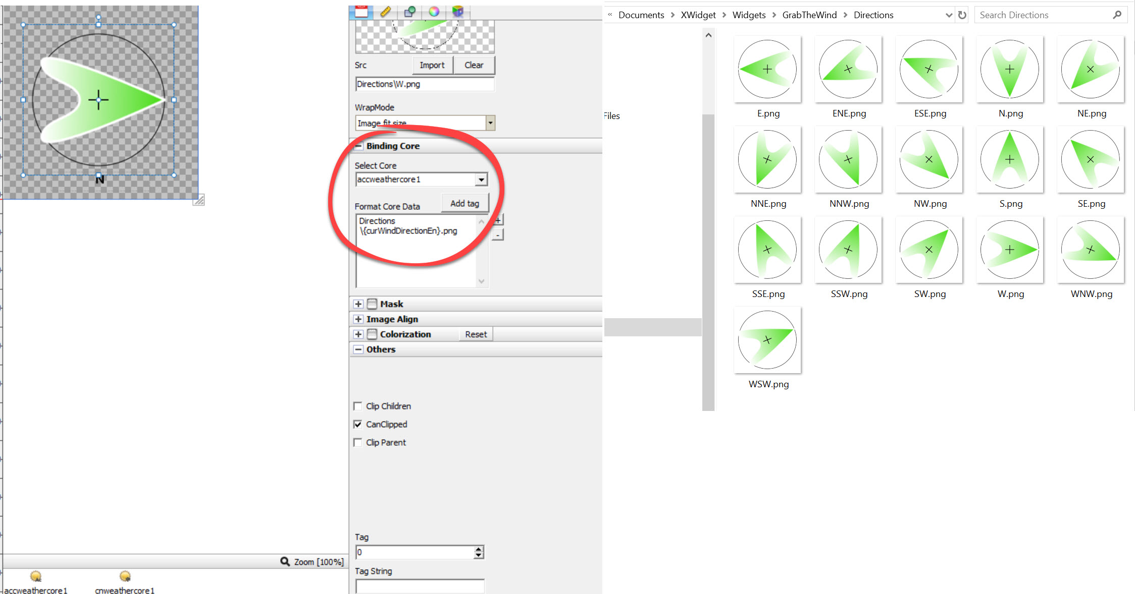

Can you direct me to an (Android) example or documentation of how to get the correct image for a direction ?
I have created a subdirectory with images for all directions and added an image object to the Widget with a Directions\{curWindDirectionEn}.png tag for Binding Core
But it doesn't work. I added a Text object and also bound it to ${curWindDirectionEn} and I get N, but the image N.png isn't loaded.

2. For the wind images, of course you don't have to create 1200 images! As I see from your screeshots you have created 16 pngs and used the "${curWindDirectionEn}" as I suggested. Good. But it doesn't work? :?
For the text you can't attach function with pngs. Text is text and it will show directly the value using the above tag.
I need to test it by myself and made a demo widget to see how it works. To be honest I don't use that because of the difficulty to assign directly wind angle and rotator. Let me see and I will reply asap.

Could you please attach a .zip here with your 16png images to test? Because I don't have similar images and I should create them from the scratch..

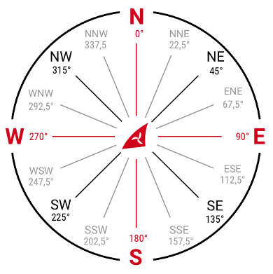

EDIT: The wind directions arrows are wrong JuzerNeem.
Should be with these angles. I'll rename them..

Here are the fixed version of the images and the demo wind widget.
..and works fine! You widget didn't work because the images were wrong :)

Are you sure they are wrong...
Since I want to make a widget for kite-, windsurfing and sailing I want the arrow to point in direction the wind is blowing to , not from where the wind is blowing.
So with North wind the arrow should point downwards.
PostPosted: April 29th, 2019, 3:09 am
Absolutely JuzerNeem. The cardinal points never change! Test the widget and see that works fine.
Accuweather and in general the weather services show the direction of the blowing wind NOT the opposite.
The tag says > Current Wind Direction
If you want to show the direction for today or next day/s , then you need to use other tag from the list
This is how it works.
