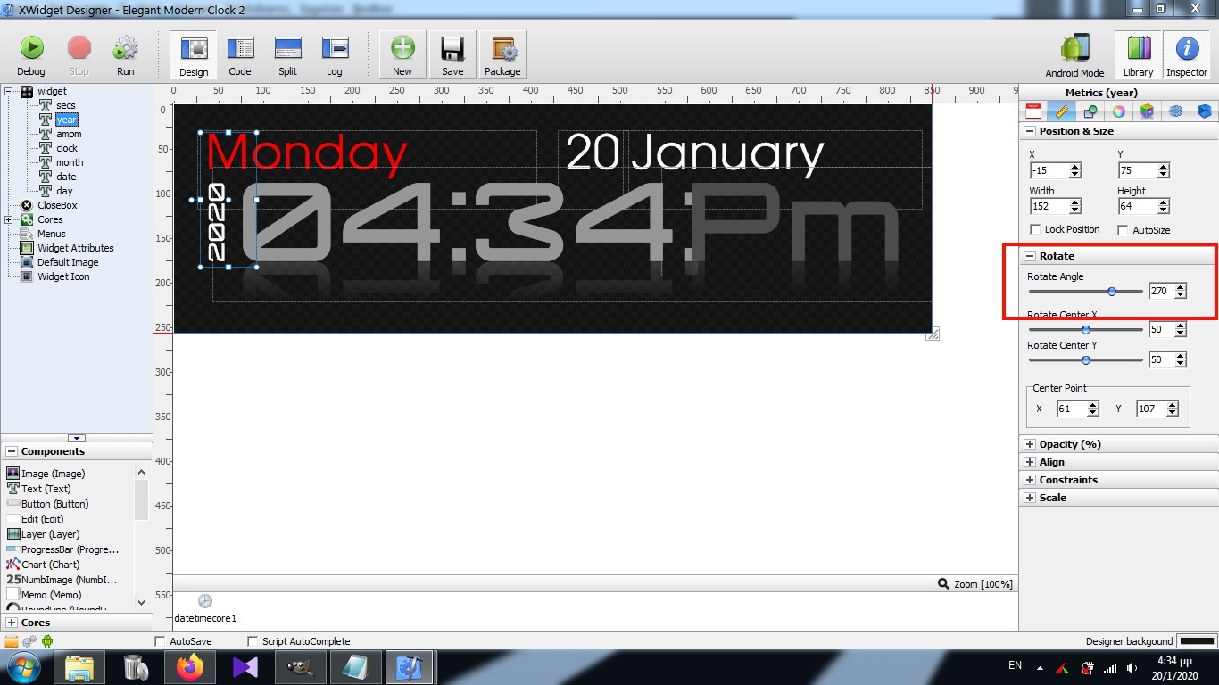

PostPosted: January 20th, 2020, 7:38 am
I checked and no, there is nothing special. I only used the Reflection option (in the Effect tab).
Year text though doesn't have it.
You didn't notice that the "year" text is rotated (check screenshot)
So rotated text / rotated shadow. ;)
You can play with the values but with rotated text always works like this...
Now, to create a "normal" shadow with vertical text , should have this form:
2
0
2
0
It's all about designing style!
(This is a bit tricky though because the year text changes and it's not a steady image.
I can tell you how to do it, because as I see very few people use it..)
