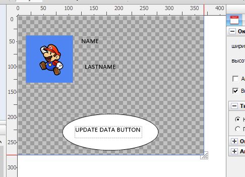

How to get a response from the API website?
Link : http://api.vkontakte.ru/method/users.ge ... 200,status
Respons json :
"response": [{
"uid": UID,
"first_name": "text",
"last_name": "text",
"photo_200": "photo url",
"status": "text"
How to make a widget that, when run, and press the button to update the data.
Photos loaded in the image

I have a yahoo widget that does a json parse and you can have that code if you want. I was going to do the same in an Xwidget but found that remote file handling is a little primitive in Xwidget. In the end I created a yahoo widget instead.
The attached widget is a yahoo widget and you could try the code in an Xwidget but I doubt it will support it, you can but try.
The widget retrieved json data and parsed it successfully.
panzer WoT winrate gauge.zip [3.29 MiB]
Downloaded 411 times
