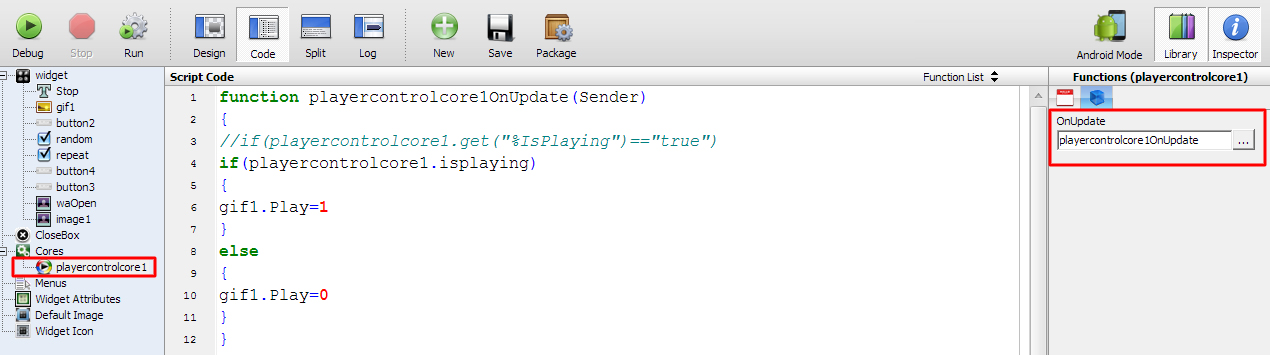

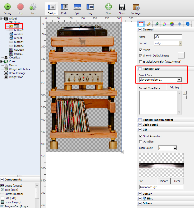

PostPosted: April 26th, 2015, 9:52 am
Posts: 112
Hi,
I think you have to do this:
1. bind the .gif-image to the playercontrolcore
2. "activate" the playercontrolecore (to use script) by double clicking into the white editing box
3. change this line of script from:
if(playercontrolcore1.get("%IsPlaying")=="true") to:
if(playercontrolcore1.isplaying)
For me it works well now.
