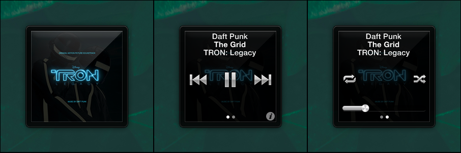

I created this skin. When you hover over the skin panel appears. This panel consists of two pages, which are switched between a scrolling mouse or by pressing on the buttons below.
The problem lies in the fact that they are switched without animation, even though I added through the editor.

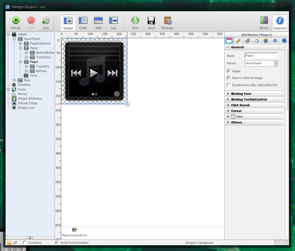

Here's how the skin looks in the editor:
Tell me how to add animation.Tell me how to add animation. I would like as a slide panel. ;)
