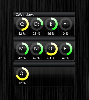

Hi guys,
Thanks for your input, it was really useful !
Digigamer, your peace of code did it !! Although I changed my initial plan and went for gradient instead, but same thing :
roundline1.fore.gradient.stopcolor = rgba(255,0,0,255);
Attached is a screenshot of the final result. My 9 hard drives color-coded to 50% green, then to 75% yellow and red above 75%. When mouse over the disk name, the full name appears on top.
:D
