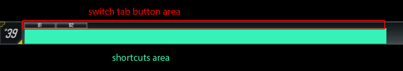

Hi jimking!, thanks for the reply, perhaps i didn't explained my self well, let me give it an other try, this is what i have in mind, each button corresponds to a completely different "set" of shortcuts, and the layers ( were the shortcuts are going to be) overlay, so when i press lets say "B1" the layers with the shortcuts of B2, B3, B4, etc need to hide, cause otherwise they will all be visible at the same time and its gonna be a mess.

The "Binding TooltipControl" can be applied not only to a "text" but with any component,layer etc..
For the button 1 assign the "layer1" with the first part of the shortcuts, button 2 assign the "layer2" ect..
Now in this case I think that you need something like this: ;)
http://jimking.deviantart.com/art/Futur ... -360004839
(remember to uncheck the "visible" option for all the secondary layers)
