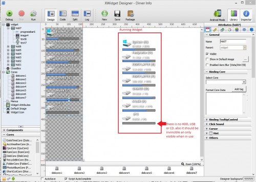

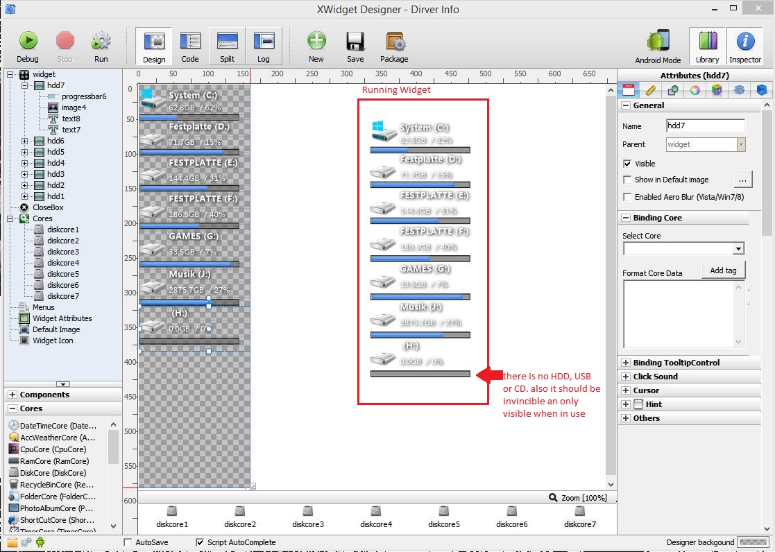

Hello,
thank you for your help.
i have do all the things, i will bind each letter from a -z to a core.
also it should be invincible an only visible when in use
watch image plz
can you help me with the script
thanks
File comment: Widget Progress
PostPosted: September 7th, 2014, 9:34 am
Posts: 362
you can use this code for visible/invisible objects:
Code:
//Script Author: Hamid
function diskcoreOnUpdate(Sender)
  if(Sender.get("%DiskType")>1)
     eval(Sender.get("%Name")).Visible=1
  else
     eval(Sender.get("%Name")).Visible=0
Note:
1. you should use function name (diskcoreOnUpdate) in the [OnUpdate] Event of each DiskCore
2. you should change the layer names to drive-letters in UpperCase (C,D,E,F,...) to make them compatible with this code

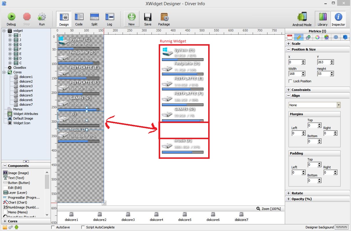

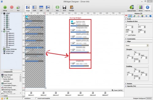

But now i have a hole in the Widget. Is there an Auto position for each Layer
Thanks
PostPosted: September 8th, 2014, 10:10 am
Posts: 362
as i said here:
Quote:
for Aligning and Positioning:
you should use Aligning to reposition the Visible Objects,
current Aligning Feature of Xwidget seems a little buggy to me,
so you can write script code to do this if needed
there is an option named [Aligning] available but seems buggy to me,
you can find it here:
1. select an object
2. on the Right-Sidebar (Inspector) goto 2nd tab (Metrics)
3. there is an option named [Align]
you can change between different Aligning Options,
since i don't use it so much, i don't know exactly which one will work for you, and if it work correctly,
but i think the [Top] or [MostTop] can be used for this,
try it first,
and if it doesn't work correctly, you can write script code to do the repositioning of objects
