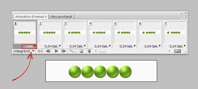

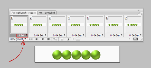

You can determine the interval of every frame of a gif. :)
... I know you prefer a solution via script, hence I will not bug you any longer with gifs and animated pngs. :D
