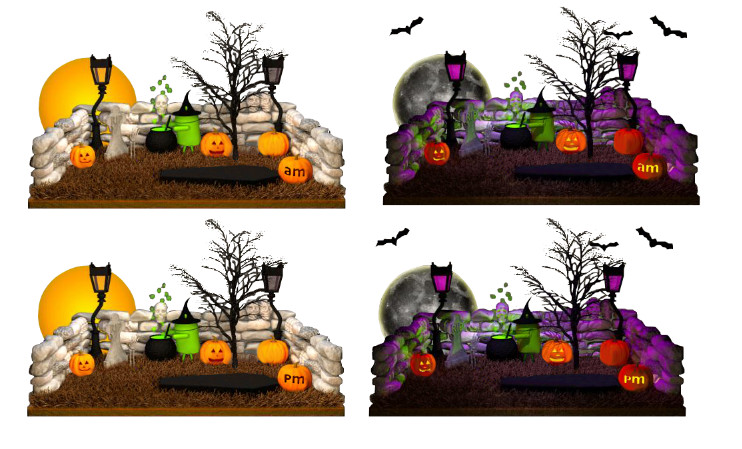

I have 4 images: AM / PM for day and AM / PM for night. I would like to show each image on the right time according the script times on the top.
I already used a similar function for this widget (check the attach file) without script but I need to be combined with DAY and NIGHT function and they will be also invisible with 24h clock.
I will try to be more clear possible:
- The day AM image will show at 6:00~12:00 call it "amday" for the script
- The day PM image will show at 12:00~20:00 call it "pmday" for the script
- The night PM image will show at 20:00~0:00 call it "pmnight" for the script
- The night AM image will show at 0:00~6:00 call it "amnight" for the script
Check the screenshots below to see what I mean:

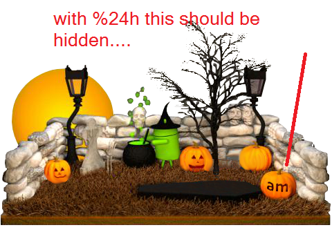

PostPosted: October 28th, 2013, 5:50 pm
I mean meme that your previous (working of course) script code is for 12h mode. This means that we have these four images:
But the am/pm are part of the images and didn't change/HIDE on 24h clock. (right click option) From 9:05 am to 21:05 for example

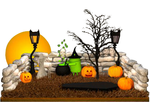

PostPosted: October 28th, 2013, 7:14 pm
Here is what I mean..
I have ready the 4 am/pm ONLY images (separate from the main image) and the 2 backgound images day/night.
