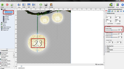

Ok I figure out but I need a little "trick". The progress bar that I use is rotated 180o because I want the zero value starts from up.
So the txt using this:
"text1.top = progressbar1.thumb.top+39;"
has opposite movement..

how about this:
Code:
text1.top = progressbar1.Height-progressbar1.thumb.top+10;
note:
change the number to adjust to your design
PostPosted: May 3rd, 2014, 11:09 am
Works great!! :D
Thanks a lot mate!

use this instead:
Code:
text1.top=progressbar1.Top+progressbar1.Height-progressbar1.thumb.top-22
added "progressbar1.Top", so it doesn't need changing the code again if you move the objects in the designer
note:
the number is the dimension on thumb image (it depends on the dimensions of thumb image)

Are actually three separate progressbars with hours,mins, and secs.
I will try..Thanks!!!
