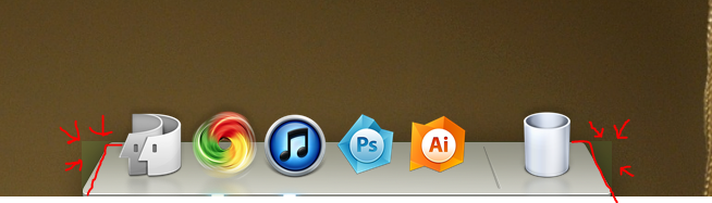

Good day! I need help with blur in my skin. How to fix this?

can you upload your dock?

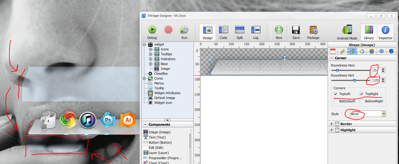

Hi,RaDMaN,the blur effect works in the whole rectangular area.
so, it's better not to use it.
or you can add corner roundness to image1.

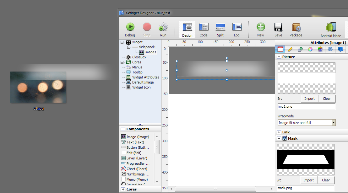

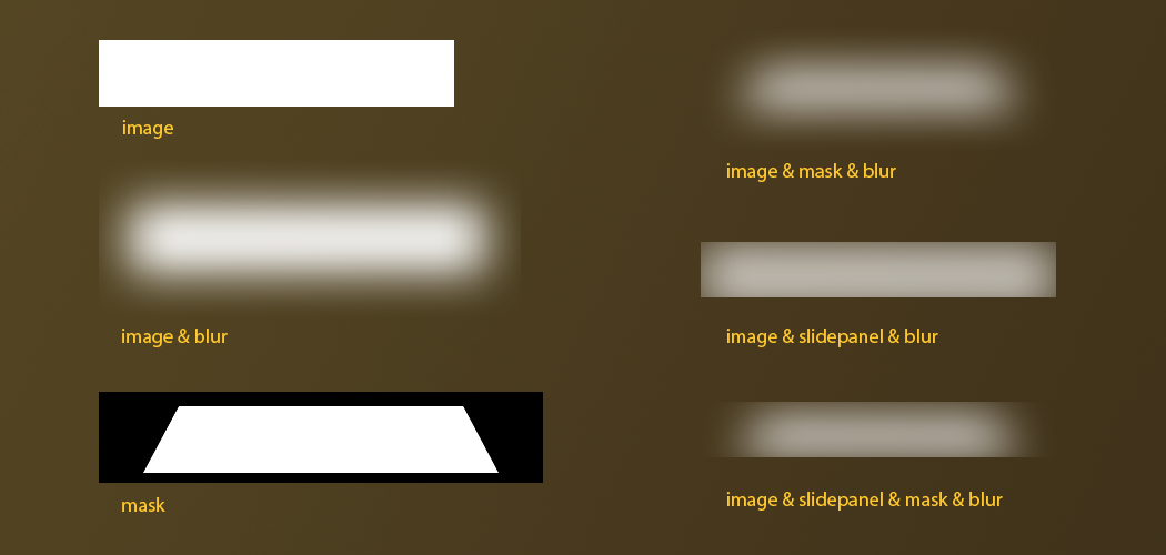

Hi,
maybe you could try a combination of a mask and a slidepanel (without sliding) to get rid off the blurred corners. By using a slidepanel you will keep sharp edges.
blur_test.XWidgetPkg [3.86 KiB]
Downloaded 284 times

Dagedee wrote:
Hi,
The attachment blur.png is no longer available
The attachment blur_test.XWidgetPkg is no longer available

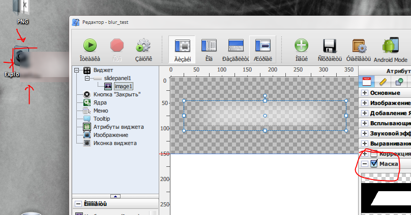

Thanks, but mask don't work with blur, look at this:

I did it. But there is a small problem. How to remove the box from the bottom? It should not be there. If he was there, he would have been on the whole area.
And why is the reflection of the icons don't appear after booting Windows? For the appearance of reflections, it is necessary to hold the cursor on the icons.
