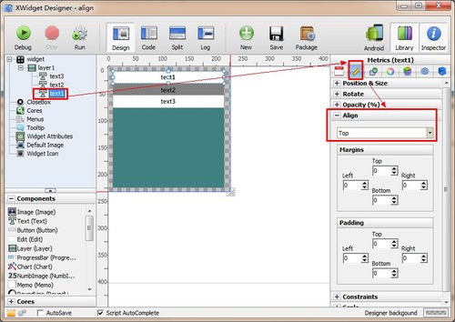

All child controls can use the same align.But child controls may be out of order sometimes.

Thanks, you got me to the right path... And for the alignment issue... XWidget parses component from bottom to top so after saving I had to manually arrange the components in my main.xul!
