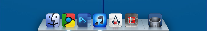

Hello there! Could help me with the dock? I make Mac OS ML Dock for XWidget:
I made a certain number of icons on the dock. But different people want different number of icons. How to implement stretching dock for different number of icons? For example the default will be two icons. After drag and drop five shortcuts on the dock. And the dock panel will stretch under the 7 icons.
How can you do this?
I really hope that you will answer. Sincerely RaDMaN :)

Awesome! You can set the dock background image control property "Picture--Wrapmode" as "Stretch" ,and set "stretch margins" ,then when the icons number change, you just set dock background image width, it will auto stretch fit

    Lets assume, your dock's background image is a control named bg.
    Set align to client.It will automatically fill the entire width.
    Set background to "stretch" and set appropriate margins.
then since you mentioned you use DnD then use this...
Code:
var ICON_WIDTH = 64; //change according your requirements
var PADDING = 16; //change according your requirements
bgOnDragDrop(Sender,Data,Point)
//add your shortcut adding code here
var grow = (ICON_WIDTH + PADDING)/2;
widget.Left = widget.Left - grow;
widget.Width = wiget.Width + grow;
If you share your code... I might help :D
