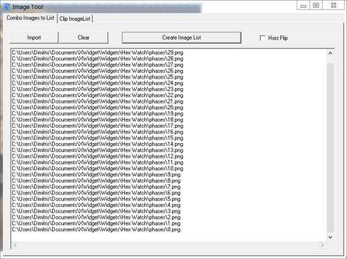

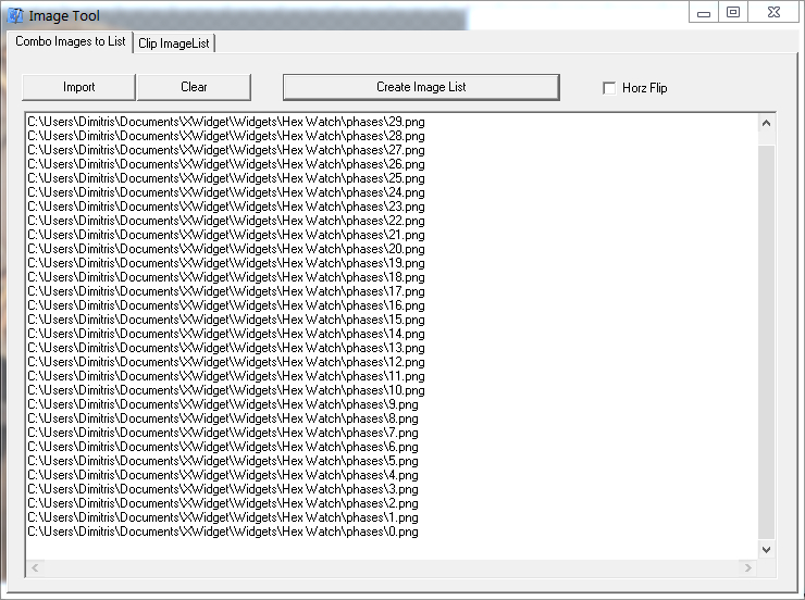

It's easy Rom. Just tested and works.
1. Click on the little gears button
2. "Combo Images to List" tab > Import
(add all your png images - in numerical order it will be more easy to know the first and the last one)
3. Click on "Create Image List" and save with any name the extracted png.
That's all
(I made a test png from the moon phases)
