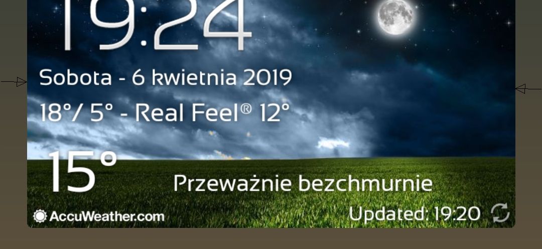

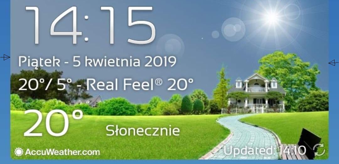

3. In version 1.94, the distance from the edge of the screen is lower than in 1.96
1.94
1.96

I am forced to return to 1.94 until these errors are fixed.
1.94
1.96

Ad 3. There is still a problem with the width of the widget

3. Please fix bug with width of the widget
As I told you (reply by Tony to me after your report) this is not a bug. It's because of the new SDK built.
Now that the app passed to Android Studio though, I will ask if this can be edited. If it's unchangeable, there is no other way, then live with it. But it's not a bug..
Thanks for testing! Wait for more replies after I talk to Tony.. :)

PostPosted: April 18th, 2019, 11:45 am
Slavoo wrote:
Jimking
Check the addition of the 4x2 widget version 1.94 and compare the addition in version 1.97
You'll see the difference where the widget is located
I know Slavoo. Even Tony noticed that! But he told me that depends on the new SDK26 that changed that automatically.
Now I repeat, if Android Studio allows to change the values for the empty left/right space, then Tony will fix it.
If not, we can't do more...
