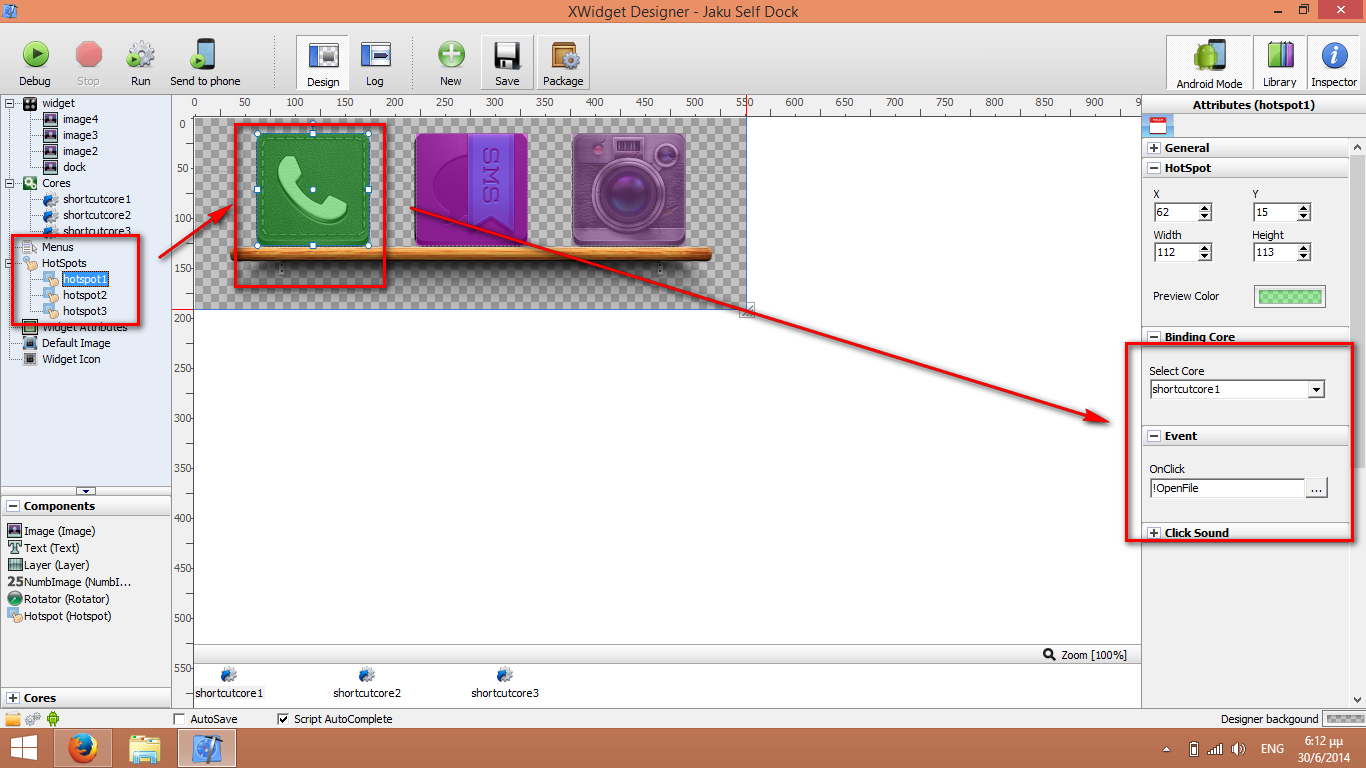

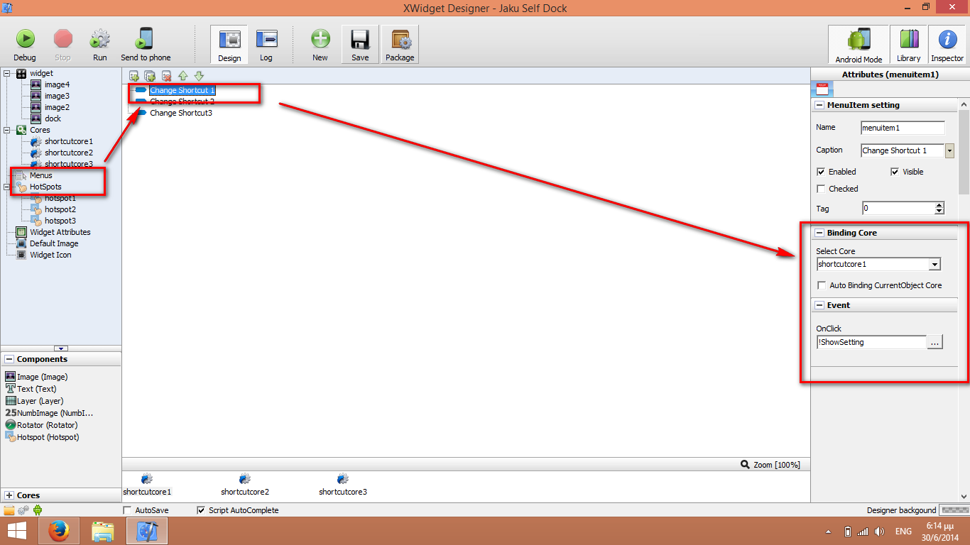

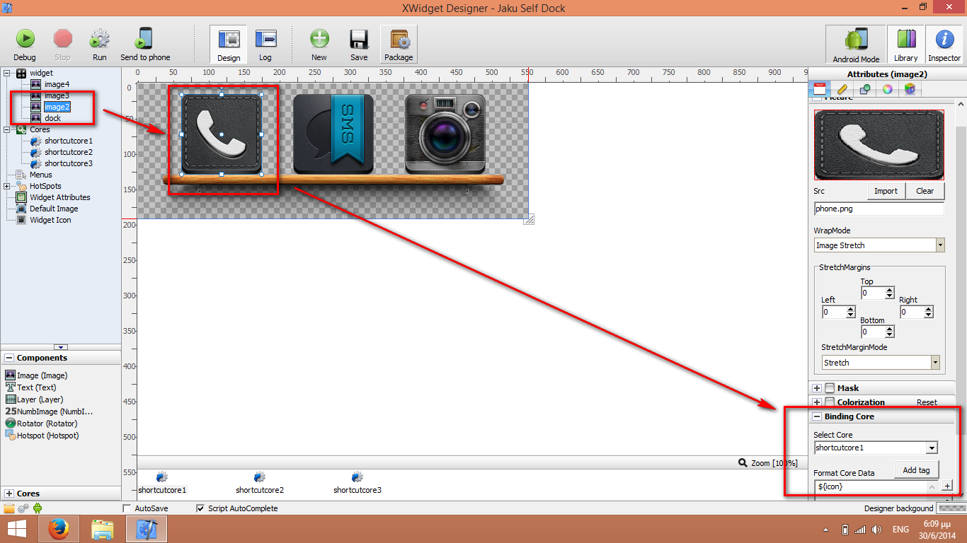

PostPosted: June 30th, 2014, 7:19 am
1) As you see you need to work with "image" components and assign a shortcut code/icon tag and clicking on "shortcutcore" check the "Enable Dradrop File".
2) Then you need to assign the core/tag for each Hotspot.
3) At the end for the right click options write the "!ShowSetting" tag.
4) For the "Caption" space you can write/edit your text there!
