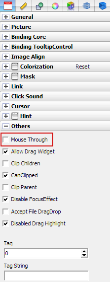

Perhaps you could try "Mouse Through".

Nope that's no good, the layer is a control. It needs to function and the "mouse through" causes all events such as mouse functions to go through to the layer below regardless of whether the layer above is transparent or opaque.
I may not have made it clear enough.
Only the transparent areas need a "mouse through", the opaque areas of the image act as per normal.
