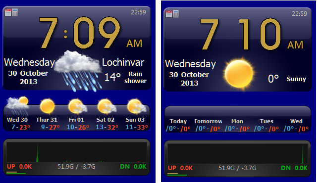

I upgraded from Version 1.8.2 to 1.8.8 with the patch, and my weathercore no longer works, see pic.
Left is V1.8.2 all OK, right in V1.8.8 weathercore not working, any ideas or suggections ?

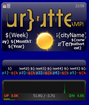

After opening the widget in designer, changing nothing, and then closing, it now look like this
had to restore from package backup to fix.

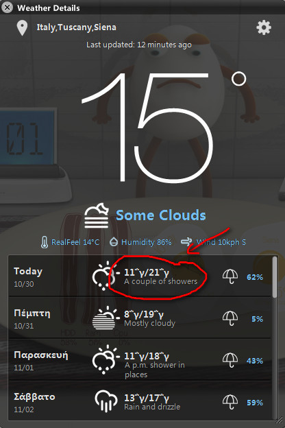

${updateTime} is missing the leading zero in minutes. It's now shown as 14:5 instead of expected 14:05 and as it was before (e. g. version 1.84 ).
${dayText1} gives as result 10-30 and
${moonPhaseDesc1} is giving moonPhaseDesc1. Are those values correct?

But there is some change: In the previous release(s), the value "%UpdateTime" was showing (more or less) the time of when you used the function !UpdateWeather. Now (v1.88) it seems to be the time when the data on Accuweather was last updated (intervall of 10 minutes?). (And - as mentioned above - the leading "0" in "minutes" is missing (which looks horrible) ;) )

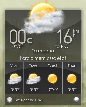

Joined: August 11th, 2012, 3:13 am
Posts: 25
I've installed the patch but still the Current Temperature and Current Real Feel are 0ºC or 32ºF. Any solution?
PostPosted: November 3rd, 2013, 2:38 am
Which widget you're using and which patch you installed?
PostPosted: November 3rd, 2013, 3:11 am
Posts: 25
Jimking, I'm using the xwidget 1.8.8, the patch given by Tony in this thread and any weather widget, for instance Tiny Weather (http://www.deviantart.com/art/Tiny-Weat ... -289065446)
PostPosted: November 3rd, 2013, 3:50 am
So the widget doesn't work at all?
Have you installed the patch that Tony posted below my comment? (close completely the program and then replace/overwrite all the files in the program files xwidget folder with the patched. Then run it again).
http://xwidget.com/download_patch.php
I tested and the widget works fine on my pc...
PostPosted: November 3rd, 2013, 4:08 am
Posts: 25
Yes, I installed the patch for a second time just in case and the widget still shows no temperature. I'm trying this other widget (http://www.deviantart.com/art/HTC-Weath ... -288352643) and same result. I'm using a w7 32bit.

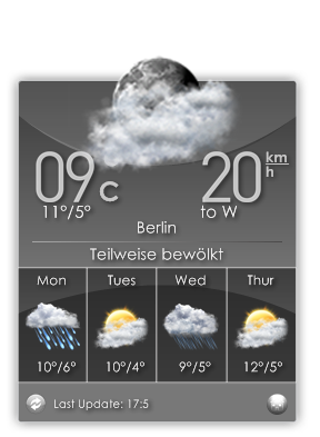

I'm using the portable version 1.88 of XWidget too (Win7x64) and the weather widget works very well.
The portable version is available here. http://xwidget.com/
Unfortunately the translation into German is not entirely correct (upper case and lower case). I could correct this if wished.

Sometimes the weather widgets not work and show all the values 0oC/F...
Seems that when I restart the program the problem is fixed but surely this is not normal.... :|

any news for weather bug? and for me the same things wrong data many times shows zero and mainly i can't find my city.in the previous xwidget i found my city and everything was ok now only big cities...i am from greece

Posts: 257
Location: Barcelona
some question about when it happens:
1. does it happen always or only sometimes?
"always" is a bit ambiguous, but I'd say yes, always.
2. does it happen at the start or at the middle?
not understand the question :(
something to try:
3. by restarting xwidget; does it fix the problem?
In my case, does not always work "restart" I have to "exit" and then start again xwidget.
Anyway, when I reboot xwidget I can get weather update. And thus I do every time I want to see the weather update: I reset xwidget.
4. by reloading widget (RightClick>Window>Reload); does it fix the problem?
Nop
5. by opening it in editor and save it and then restarting xwidget; does it fix the problem?
I have not tried, but restarting xw the problem is resolved. In fact, momentarily resolved ..
6. by using tags in code (as "${}"); does it fix the problem?
I do not understand. In fact "core binding" it used: $ {curTemp}, $ {cityName}, $ {curWeatherIconNum}, etc.
7. by using tags in code (as "%..."); does it fix the problem?
As experienced in other widget, when you change "$ {}" to "% ..." xwidget automatically leave it again: "$ {}"
But I can be mistaken about this.
