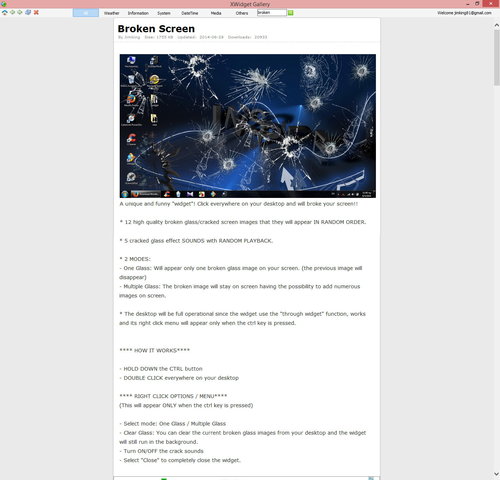

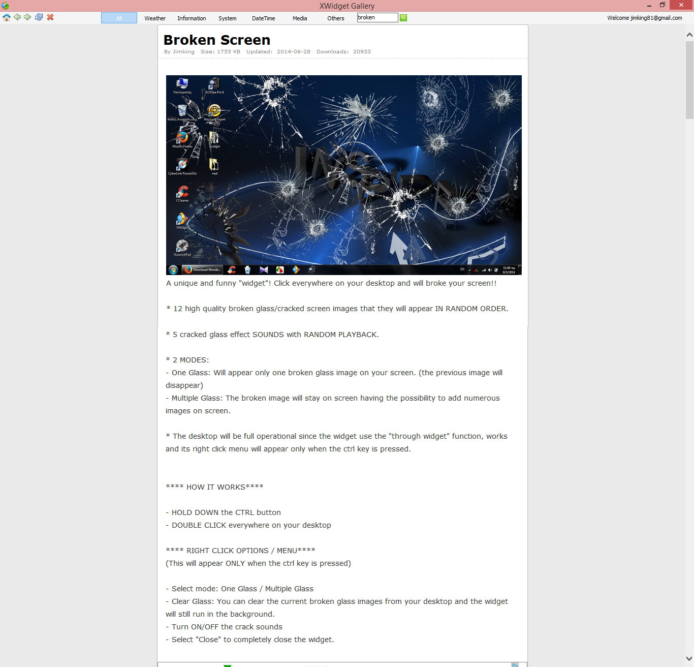

PostPosted: March 15th, 2018, 5:00 am
Please check the description about 'How it works '
I tested days ago and worked fine...
Quote:
**** HOW IT WORKS****
- HOLD DOWN the CTRL button
- DOUBLE CLICK everywhere on your desktop
**** RIGHT CLICK OPTIONS / MENU****
(This will appear ONLY when the ctrl key is pressed)
- Select mode: One Glass / Multiple Glass
- Clear Glass: You can clear the current broken glass images from your desktop and the widget will still run in the background.
- Turn ON/OFF the crack sounds
- Select "Close" to completely close the widget.
PostPosted: March 15th, 2018, 5:14 am
We are getting off-topic but when the user runs your widget, how are they meant to know to operate it?
Should it not put some sort of indicator, a little help onto the screen first? A widget without help regarding operation is useless.
Back to the original topic, please raise it as a bug for Tony.
PostPosted: March 15th, 2018, 6:52 am
Com'on..
That's why I ALWAYS add a DESCRIPTION man..(!) For all the widgets, even for the most simple ones.
All the necessary infos are written there (DA and xwidget galleries). The people need to spend 5 mins to read it. If they are too lazy to do it, it's not my fault..
For the rest, I have already send a pm to Tony to check your last reports :)
