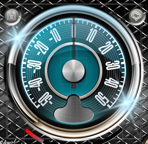

I checked my design and the needle has:
StartAngle: -135
EndAngle: 270
Temperature in C.
I have two face "clock" images with both temp units F and C..
The fact is that I already have 121 images with the movement of the needle. I tried to select some of them to match with the above values, but is not accurate at all..
This is a port from an Android app.
needles.zip [1.85 MiB]
Downloaded 875 times

edit:
ok, now i found what you mean,
your images are not match with the original image,
you should adjust them based on bg image, since the bg's range is not accurate
maybe my example widget can be helpful on choosing which one match the bg,
change the binding tag with numbers to find out which one match
you can specially test it with "redarrow_30.png", and you will see the difference between bg's 30degree
or we can use script code instead

Yes I mean your example.. At the test widget that you send me, add a right click option to change location and make some tests.
For the high temps the needle goes "out"..
If you can do it though script with the angle values that I wrote you...

Posts: 362
it's ready:
Notes:
1. the script automatically detects both C and F,
2. if you want the old values before update, but don't want text object, you can invisible the text object
after you have done designing, send it to me to optimize the code if needed

Here is the final version. ALL WORK OK! Check the right click options and the on top buttons! :)
(I had to make a little trick to combine both C and F panels. Since the text object that has the "OnChange" tag and the "rotator" must be twice, one for temp in C and one for F, I added a second core and I copied the scipt changing the text1->2 and rotator1->2)..
viewtopic.php?f=11&t=5015

I understand all the parts.. If you want to edit and fix these part of the script.. It's up to you! :)
Quote:
there should be used a code to force each core use their own unit,
i'll fix this, if i kept both cores
Sorry but why we need a code for this..?
The cores are two, right? When you click on it you can select which type of units will load on startup!
So I selected "metric" for the one with C and "imperial" for the other. So each core will show separately what I selected. And without any right click option to change unit, they will stay like this!

ok, it's ready:
old_school_dashboard [test] [2014.09.16]1523.xwp [4.47 KiB]
Downloaded 855 times
Notes:
1. you should add deleted images&fonts to widget
2. you should adjust the objects' position if they needed
Changes:
1. Added: Saveini and menuitem checking for menuitems
2. fixed: location changing by removing one of the accuweathercores and changed the code to work only with one
3. fixed: celcius/fahrenheit changing by changing the textonchange function in the code
4. fixed: slidepanels to not get in the behind of another; now when you slide one, other one will slide-back
5. changed: position of [time] and [date] objects to [timee] object in the widget tree; to be compatible with changing clock mode and saveini; (also i have adjusted the position of them in new place; check the position of them to be adjusted)
