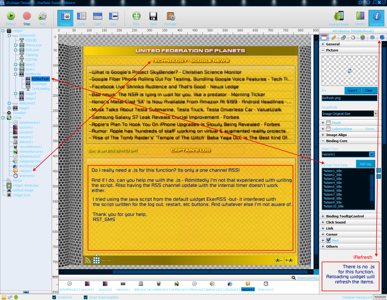

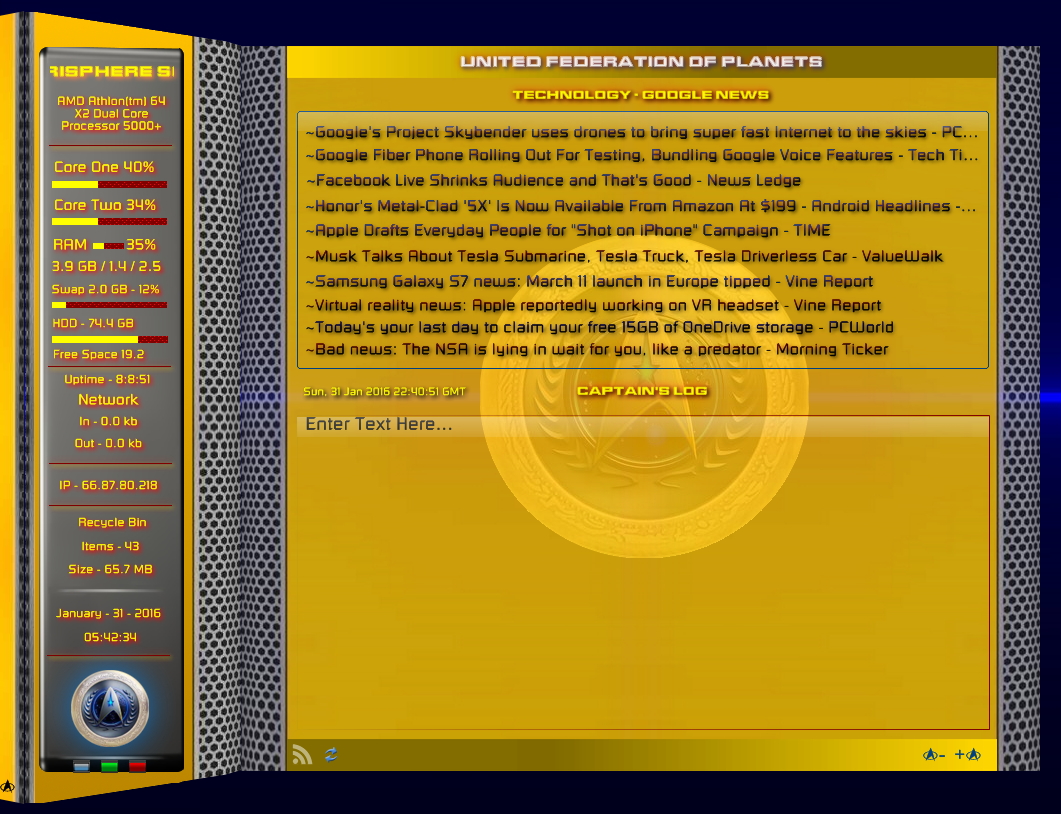

:?: - Help anyone, Here is my second widget I'm working on, its nearly complete, and would be if I wasn't having problems with the one channel RSS feed. *Ugh* - The issue is, the channel won't update (!Refresh) wheather by the refresh image, the Update RSS menu item, or by the internal timer. Reloading the widget will update the channel.
I'm hoping the screenshot provided will help to explain the issue more.
There is no java script for the RSS channel. Do I really need one?
Admittedly I'm not that experienced with .js. However I do have a low level of understanding with .js.
I tried using the script from the EkerRSS, but it only interfered with some of the cores and the login text.
If I'm not allowed to use script from someone elses widget, I'm not aware of that, and haven't found any restrictions stating that it is not permitted - so sorry, if I erred.
Anyway, anybody here willing to guide me and or give me the script fix? - and or the fix?

PostPosted: February 1st, 2016, 2:04 am
Topic moved to the right section (you posted in the Android section)
1) Yes, you can use js codes from other widgets.
2) For the rss core no need to use any js. The core has all the necessary elements.
DO NOT FORGET THE RIGHT CLICK OPTIONS THAT ALL THE CORES HAVE.
There are a lot of widgets that use rss in the gallery (and in my gallery on DA) to check how it works.
Check the RSS widget/s from this suite for example:
http://jimking.deviantart.com/art/Rusty ... -535164731
Note that some rss feeds not work though (depends on the extension that the rss link has)

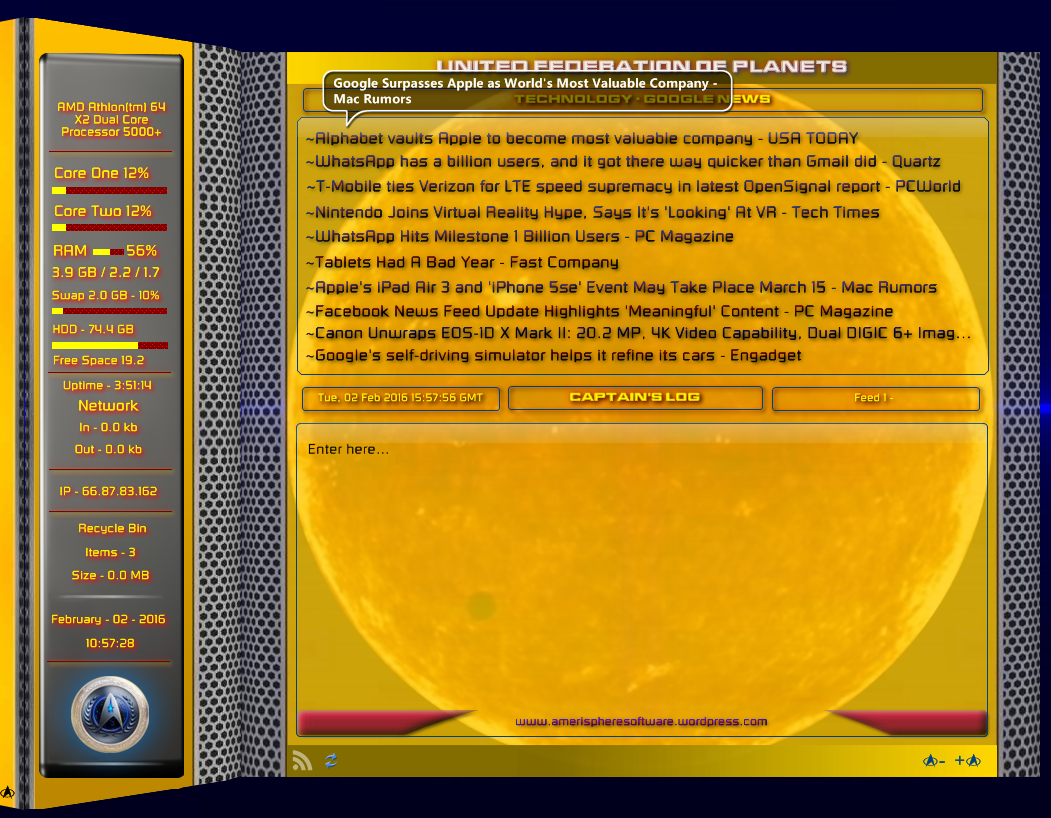

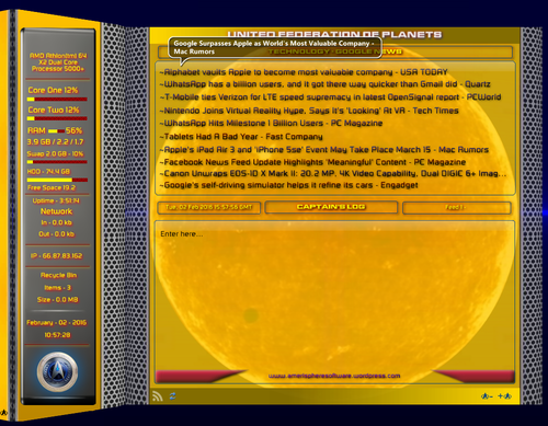

Ok, I just found out the feeds are updating, its the feed text fields that aren't changing (see screenshot.
Use the image I provided to see how the "Hint" is different from the RSS Item. The RSS Item is updating when I press the "Refresh button. However, the RSS Item text field is not updating.
I've tried 100 times to find a fix, I'm unable to find the problem. I think its in the script, and this is where I'm struggling.
I understand this is a personal problem, and I intend to understand the script.
It would be nice though, if I could get a little nudge (help) and assistance.
