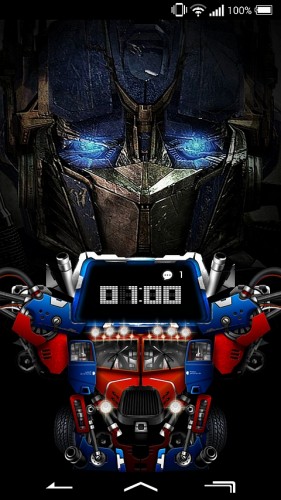

The project has a lot of slidepanels but fortunately I need the script only for two.

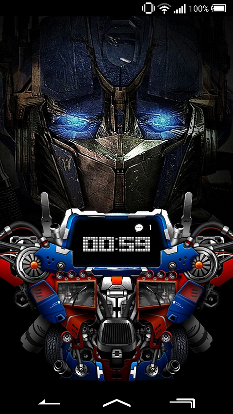

It calls "Optimus Robot Clock", an idea from an Android lockscreen theme and will work like this:
BEFORE and AFTER the double click:
If you want I can send you the .xwp to check it..

for the correct position of eyes, look at this:
also you can find more by searching for it

I edited the eyes' shape according your suggestion and the size, but personally I prefer the old position of the eyes. In this place, the head of the robot seems too small.. Also I like the more "aggressive" eye style. But this is my personal taste!
I think that we see two different robots there! :lol:
Thanks for the script. Here is my final version and I will upload it now..
optimus_robot_clock.xwp [1.59 MiB]
Downloaded 644 times
I have already checked mate!!! But maybe you need to notice that in my design there is NO head like the original! :lol:
Only the body. So I had to "create" a custom position of the eyes...
...and if you check closer, my position of the lights are more similar to the original.. Trust me! ;)

Now...take a look here... 8-)
You will notice that the "eyes" are now the Optimus core light and many more..... ! :D
optimus_robot_clock.xwp [1.74 MiB]
Downloaded 652 times

PostPosted: September 11th, 2014, 10:49 am
Posts: 362
it's really better than original :D
where did you found that image?
it really match the widget
i think it's better to upload them as 2 separate versions,
since both are fine
as i see now, the menuitem is not necessary
as a suggestion, how about head being behind glass and from there goes up,
but i'm not sure, just suggesting
and how about the slidepanels i noted,
did you have any plans for them or leaving it that way?

Haha! Look:
- The "lightl" is linked to "eye.png".
- In this version with the head I use only ONE light image (the above) and I deleted the "lightr" as image/object .
- So the light image is actually one, scale 140% and with "Colorization" option enable, with full brightness, I made it white.
- At the end I kept your script deleting only all the lines with the commands for the "lightr".
Thats all! :)
