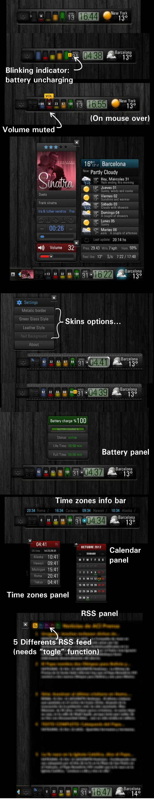

Here are some screenshots of previous BETA VERSION I'm working on new screenshots ...

They're missing some details:
RSS: make "toggle" to switch between an RSS feed and another (I don't know how to do this ... can you help me?)
Mini bar info: The widget includes 2 mini bars information: music info and time zones. I think it would be good way to incorporate the "toggle" between them.
This mode "toggle" could be used for several other things in the widget... I have not implemented by ignoring how...
Anyway, tell me what you think. And if anyone wants to suggest something or help with the "toogle" ... are welcome.

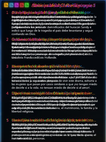

3 bugs
  • the rss could not auto hide one column when another appears.

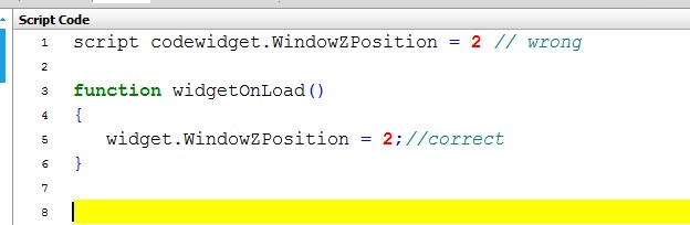

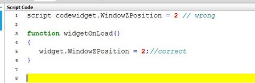

Your code is wrong... You could not write it in this way
"widget.WindowZPosition = 2" must be written in widgetOnLoad function.
PostPosted: November 17th, 2012, 6:03 am
Posts: 257
Location: Barcelona
Great!!! thanks qiancang! I'm terrible with codes...
